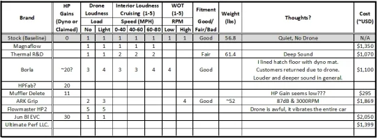

    I've been looking at the forum for hours. I've put together this incomplete chart comparing exhausts. I realize the loudness of the exhaust is relative and is somewhat based on the individual. However, this should be a good start for someone to hone in on what they would like to have in an exhaust.
    For example, I would like the to cruise quietly down the highway (no drone) and yet yield as much power as possible at WOT.
    I'm keeping the numbers (1-5) relative to the original exhaust; where 1 is quiet (equal to stock) and 5 if very loud compared to stock.
    I'm willing to update this chart if people would like to give feedback. Hopefully, this will help others as well as me.

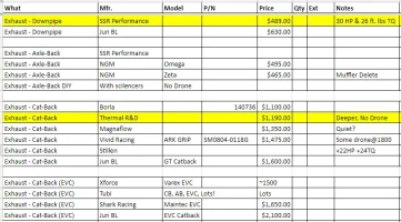

    Here is mine. Not quite as qualitative as yours but has a few different options to look into.
    • Informative Informative x 4
    • Like Like x 2

    Wildbill, that’s pretty cool too.
    This is the stuff a new guy like me is hoping to find!!

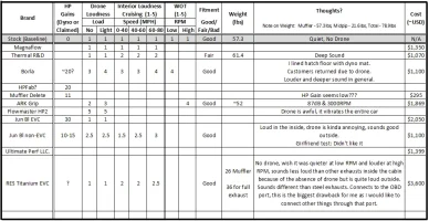

    RES titanium EVC (electronic valve)
    Cabin loudness @ 0-40: 2
    Cabin loudness @ 40-60: 2
    Cabin loudness @ 60+: 2.5
    Drone: None at all RPM with open valves, a little bit of a humming sound with closed valve at high RPM
    HP gain: N/A, but car feels faster. Didn't dyno it.
    Fitment: Good
    Weight: muffler only 26lbs, full exhaust 36lbs (vs. 79 stock)
    Price: $3600
    Thoughts: No drone, wish it was quieter at low RPM and louder at high RPM, sounds less loud than other exhausts inside the cabin because of the absence of drone but is quite loud outside. Sounds different than steel exhausts. Connects to the OBD port, this is the biggest drawback for me as I would like to connect other things through that port.
    Girlfriend test: Passed

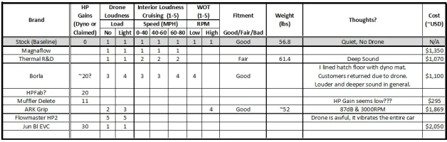

    Here is the latest:
    • Informative Informative x 1
