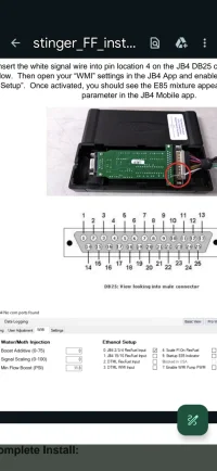

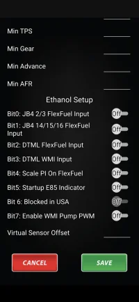

Just a little resurrection here. I just installed the fuel it sensor and have everything set up right the fuel it sensor and app are giving me an E27 reading. The JB4 not so much. The thing is on bit 0 it shows Bit0: JB4 2/3 FlexFuel Input
However if you look at the instructions and it shows for the windows OBD 2 program to enable bit 0 and shows 0: JB4 2/3/4 FlexFuel Input.
To me the app is missing the #4. I'm including screenshots. Anybody have an answer for this?TYIA.-Josh
