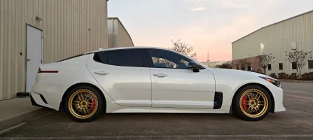

Enkei 8.5x18 is the sweet spot, for sure. We have TFRs on both our Stinger and G70. 255/40R18 for road riding. 245/40R18 for dedicated track set, though I might try 245/35 or 255/35 next.MSR Cresson 1.webp

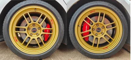

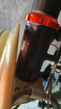

Latest acquisition. 18x8.5 ET40, local seller. Wasn't too sure about the gold color at first, but the deal was too good to pass up. Trial fitted on Stinger front, and against the Snow White Pearl, it wasn't as loud as I had thought. Rim just cleared the coilover, but for sure tire won't. 5mm hub centric spacer should correct that within 1mm of stock scrub radius, which is what we do with our TFR 18x8.5 ET38.
On the rear should be spot on as is.
Have not decided what tires to put on. Maybe some gummy 255/35R18 for dedicated track set.

Mine also cleared the coilover. Tires, though, might not, depending on the width. 225 and 235 should. 245 and 255... probably not.
With 5mm hubcentric spacer added, tire fitment should be no problem. For the front, I would want to do that anyway, to make effective offset 35mm.

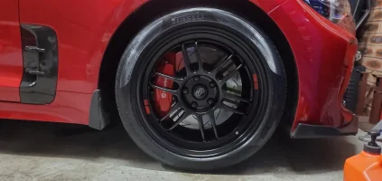

Nonstop heavy rain this past week finally stopped, so I popped these on over the weekend to test them for a while before next weekend's two-day AutoX. These tires are stiff and noisy - turn in sharp and corner excellently but I wouldn't want to daily on them.
Wheel barrel just large enough to fit over the Brembos, with barely a few mm's to spare. Just the way I like 'em.
