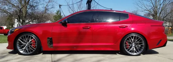

3.3TT Eibachs
Agree! looks good. did you get the alignment after the spring? that's what concerns me too.
No alignment yet, getting new wheels in a week or 2 so I'm gonna get one right after I get those installed. Drove the car only 2 miles so far and haven't noticed any pulling to either side.
Great job, looks good.
Any feedback/issues with your active suspension? Any good or bad things to report?
So far nothing to report. Didn't get a chance to drive it much since my ride home was less than 5 mins lol. The ride did seem a little stiff, but maybe that's because the springs are so fresh? Need some more time with the car to really notice the new feel.
You’ll want to wait some time before getting an alignment to let the springs settle. A week or two or a couple hundred miles.

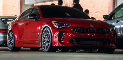

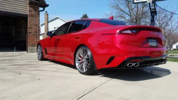

Your car is beautiful bro! I plan on doing 20x8.5 in the front and 20x10 in the rear. You dont have any rubbing or turning issues do you?
not at all I would not recommend a 10 wide unless your okay with the overall wheel diameter being larger than stock or if you are okay with the stretched tire look
That looks sweet. What wheels are those?
