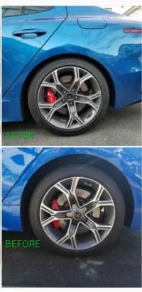

Unfortunately I got called into work during the beginning of the install process smh. Wasn't able to get any pics or vids. But the drop actually looks very nice and definitely noticeable. Here's a quick before and after picture of the rear tire. I tried to tell my friend to take a bunch of pics in my absence but that didn't exactly happen either...Sorry guys. And those are 18" wheels fyi. [Awd]
Nice
Great job, looks good.
Any feedback/issues with your active suspension? Any good or bad things to report?
Agree! looks good. did you get the alignment after the spring? that's what concerns me too.
