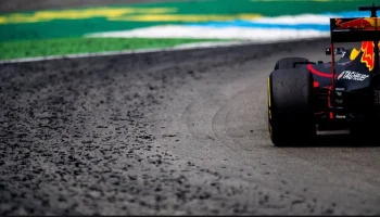

Merlin the "marbles" are small pieces of tire that come off the race cars tires during a race, during the course of the race the marbles build up outside the racing line. If a car gets into these marbles it loses grip significantly.
Marbles on F1 track:

That may be a picture taken after a race has completed and the car has run off the racing line (through 'the marbles'), but there is no way that car ran a competitive lap with that amount of crap adhered to its tires. Racing tires at operating temperature are sticky like fly paper, so they'll pick up everything that's loose. :)
You are correct most of what you see on that tire is rubber debris it picked up while driving through marbles while the tire was hot. There's more information than anyone would ever could want to know about F1 tires here: Using Tires
