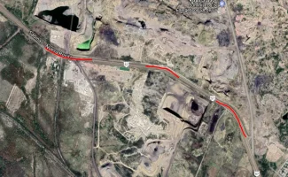

My commute round trip....
First image.....A good performance suspension when taking the 3 curves highlighted in red at +/- 125 km / hr, better than stock suspension...:thumbup::thumbup:
Second image....A bad performance suspension when taking this curve at the same speed, tested last night. I was driving in the high-speed lane and when I got to the curve, I had to divert my path into the low-speed lane because I felt I was losing control ... :eek::eek::mad::mad:
So, I am going to change the sway bars setting to stiffer setting.:cautious:

So if I’m reading this correctly you’re saying you could take the same curve at a higher rate of speed with your stock suspension? Or are you only comparing against a previous car you had on the same curve?
If you are going to do track type driving then hard setting is better.
Those don't look like very tight curves, and 125 km/hr isn't all that fast - plus yours is the first report I've read where someone has even felt dissatisfied, much less feeling it's worse than OEM.

..... Do not even think about taking those curves at that speed with the stock suspension( No problem at 90 95 km / hr).
The Maxima was well planted in the same curves at 125 or more km/hr....
Yes, indeed....but no, it is not worse than the stock suspension performance, I just expected a much better performance with the eibach's kit in those curves at this speed...
