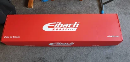

Picked up sets today :)
Tomorrow for me.
Anyone Tee'd up their install yet.
I know 2 sets left warehouse for WA this morning. ;)
Got mine today, great overnight service.
