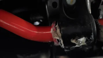

@DaJackson @Tonkabob has reported some creaking after installing the front sway, have you experienced the same? I've bought both, but not sure if I should install the front one.
Rear sway bar - installation
Cc @MerlintheMad @Ruturaj

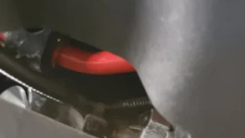

I have just spoken to a suspension specialist and they have said that there are two possibilities as to the cause of the creaking.
1. Not enough grease on bushes
2. If you only have one sway fitted the car will twist more when cornering as there are two differing types of sways fitted. He suggested that you should fit both and keep setting front and back the same.
YouTube it, I am sure I saw something on the creaking and Eibach sways. Fix was a water proof marine grease.
I started that thread. While not everyone seems to have experienced the issue, here in Atlanta over the winter we had record rainfall and I believe that exacerbated the issue. There are grease ports so you could inject grease every time it starts to make noise. Though after using the tef-gel recommended in the youtube video it's been silent so I'm hoping it will be a longer term solution.

There are grease nipples. The bottom of the car has plastic shielding, there are small openings in the shield near the bushings so you could access the grease nipples with a grease gun with a flexible hose, but the car sits so low working room is limited unless you lift the car.
The general rule is you don't mix different kinds of grease, so only use the nipples to inject the same grease that you originally lubed with, otherwise if you want to try a different grease dissemble, clean and then apply.
Thanks for that bit of info - if all stingers come with grease nipples then that is a no brainier.
As for the grease - if you are not doing that maintenance yourself then how do you know that the shop you take it to is using the same grease?
