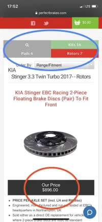

Here’s a look at some early pricing. The Two-Piece rotors and Pads are available. There are a few tabs up top to look at pads, rotors and kits. Looks like the solid rotors aren’t available yet, but pricing is up. KIA Stinger 3.3 Twin Turbo 2017- - Perfect Brakes Discs, Pads and Shoes

Am i blind? I dont see any pricing just call for picing.
