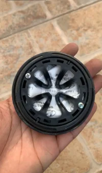

same us in photo still DBL not working any help ? i try to disconnect batt... also not working

still same problem and i change it with new one in both sides
Can you elaborate on what you mean exactly by, the same problem?
Most people's problem was that the light was impacting physically against the swelled desiccant pack. Are your DBL motors not working, and they are not impacting the swollen desiccant pack?
i mean after i change the MOISTURE ABSORBENT and BRACKET with new one in both sides same as photo i shared , the sign in dash is still there and the DBL not working nothing change my headelights even not dancing when i turn car on i dont know where is the problem
And this is after clearing the code? The code returns immediately?
