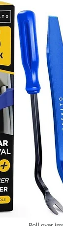

The correct tool to remove those clips is a "must have".

I bought tool set similar to what you recommended, just trying to figure out which one of five is best for clip removal.
I use the one with the blue handle and the black metal prongs.
You want to slide the prongs under the cap and then use leverage to pull the cap back out to the original position (see clip photo). Then you can remove the entire clip.
If you have broken the top off the clip, then this tool probably wont work.
When the top part of the clip is pushed into the base, those prongs at the bottom splay out, which holds the clip in place. If the top of the clip is broken off, then you want to try to extract the remaining post in the center, so the prongs "un-splay", and then you can remove the base of the clip.
I hope this makes some sense.
I have extra clips, so I can take some photos and post them if that would help you.
Will try it tomorrow on the other wheel.
