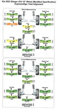

Merlin. ~6500 mi. First alignment. Based on what a friend in the field says, few cars come off the truck with a perfect alignment. Customer never notices as the car drives straight and all. By the time wear is noticed it's blamed on everything but the factory.

I'm glad I forced their arm to do the alignment. I took a printout of the kiatech instructions on replacing that bearing shaft. Interestingly they show to do an alignment on the 3.3 but not the 2.0. Makes no sense. On either model the ball joints get separated to get enough room to slide the shaft in. Anytime you touch steering/suspension parts an alignment should be done.

Me too. I called the recommended alignment place and asked the key question: does c. 3/32nds of rim wobble make an alignment impractical? "Yes, you cannot fine tune the alignment if the wheel is out of true more than 1/64th to 1/32nd of an inch." So, I wait until I switch to my OEM wheels (and get my TSW RR wheel straightened): by then my PS4S rears should be mostly gone on the inside (new on, 3 May 2021, so, that was quick: should have gotten an alignment years ago, it looks like).
I got what I paid for with my alignment. Wheel slightly cocked to the right. I suppose this isn't terrible given the alignment is at least in spec now. Just can't win.

Oh. I didn't report on this thread: alignment showed rear toe quite a bit out, which accounts for the inner edge wear and cupping that was starting. RR wheel straightened and balance on all four corners checked and corrected, and my ride is buttery smooth again, even at 120 MPH. :)
