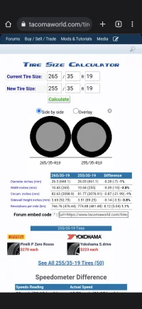

Sorry I should have mentioned...tires are Michelin Pilot Sport All Season 4's. 265 35 19 and 235 40 19. Rear tire specs are negligible diameter difference not enough to cause such wear..

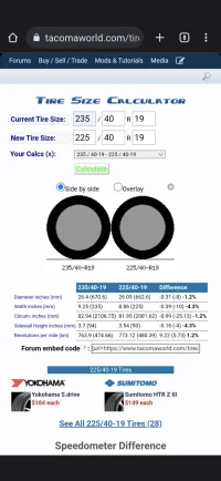

..and front tire spec. comparison ..
Negligable diameter difference also..

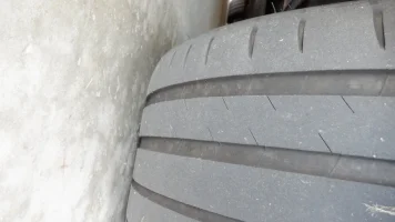

So, wanting to get to the bottom of this, I just returned from my tire and wheel guys, and they got the car in the air and immediately saw the cause: the rear tires have inner edge feathering/cupping. The pic doesn't show it, but I include it to show where my inner edge rear tire wear is at: it's even on both sides, this is the RR tire. When the tires are rotating in the air, you can easily see the inner edges dipping and rising as the cupped areas go around. I also have a slightly bent RR wheel, you can see the outer edge moving in and out c. 3/32nds of an inch (no clue when/how that occurred).
The bent wheel isn't the culprit, though (just something I will attend to when I change wheels): it is toe, pulling at the inside edges just like @Ahawk1968 's, but not nearly as bad. When I get this taken care of quite a bit later (too late to save the rear tires, and so I will just finish wearing them out: got plenty of time at this rate :D), when I get the alignment done, I'll try to remember to give an update.
