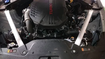

3.3TT DIY intakes w/Heat shielding drop about 0.2sec off 0-60

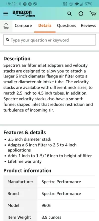

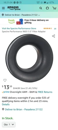

What was the part# for AEM filter? Just realized the filter that's in the set is 6in. Dont i need a 3in if I'm using oem tubes?
21-203DK​
Thanks! I have the 21-2093DK right now which is the 6in. Thought it would come with a coupler but maybe i can find one.. was trying to reverse engineering the AEM kit Haha
I get what you are trying to do now. So you need something like this it seems.

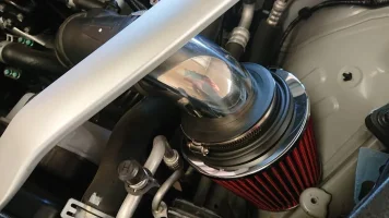

So I recently went to a few car meets and got the tuner itch again. I threw on my homemade CAI(cool air intake;))system with heat shielding, but before I did I ran another stock 0-60 test to get a good baseline. I know video editing is not the most accurate measurement, but I’ve run consistent stock 4.8sec 0-60s using this method. I do my best to crop at the same frame for each run and was even a little conservative on the DIY intake run of 4.6sec. I’m amazed on the improvement just intakes made and can’t wait to add exhaust and see what that does next.:D See below for pics of intakes and video tests.

The 4.6 run with DIY CAIs!
A 4.7 run with DIY CAIs and Autohold launch. Little slower off the line but still faster than stock.:thumbup:
