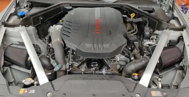

I opted for K&N filters with the little water socks on 'em. The sound is fantastic! This + snorkels is a great intake upgrade :thumbup:
Sorry for the dirty bay XD Some of the dirt roads around here kick up a TON of dust

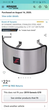

Figure I'd give it a try. Works well on a G70. Spent $170 for parts on Amazon. Could have been closer to $130 but I wanted to go with the AEM Dryflow filters instead of the Spectre filters. Hate having to oil air filters. Haven't tested it out yet but everyone seems to have a good experience with the DIY intakes. Forum won't let me post links. I attached a pic of the heat shields I used.
I added heat shields to my Spectre filters today. These are Spectre 8130 heat shields to go with the 8130 series filters. $20 CAD each on Amazon. They slip under the hose clamp that holds the filter to the pipe and fit really well.
The passenger side shield fits with lots of space but the drivers side is a lot tighter. I had to trim the corner of the shield on the fender side with some metal shears in order to get it to sit where I wanted it so that it won't rub on anything.
Overall though these fit great and should help with heat soak. They should also help pull in more cold air especially with the Big Mouth snorkels.
