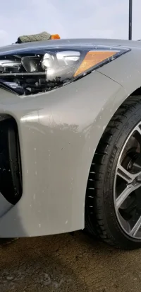

There is some rust in this headlight. I don't think that the headlight itself is rusting. But the fact I just picked this car up and there are many rust spots in a little ridiculous, right? I am really hoping Kia fixes this problem.
I don't think where you see that rust in the headlights is a metal surface, that is likely surface or subsurface iron contamination exposed to water which caused rust. Are you sure the rust on your Stinger is actually rusted bare steel (because of a paint chip)? If you looked at my car, you'd think I have hundreds of rust spots all along the doors, but mine is because it is white and the brake dust is sticking to the top of the clear coat and rusting. A bottle of Iron-X would help identify this for you...and clean it up at the same time.

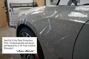

Got the car back tonight, have to say I’m very happy with the results. Can’t even see a blemish unless you are looking for it at from 6” or less. Wrap is immaculate. Autoshield Columbia if you are in the are great work. Will take more pics of wrap in the sunlight tomorrow.
I say superb! And that was quick work. :thumbup:
You won't regret the full frontal PPF.

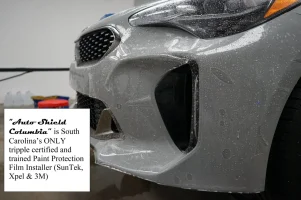

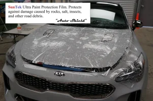

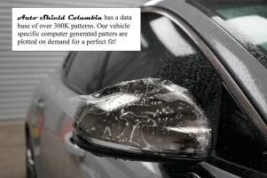

Autoshield Columbia took some great pics while wrapping my car last Friday. Next, Borla exhaust & Injen intake Wednesday Autoshield Columbia2.webp Bumper wrap.webp Hood wrap.webp Mirror wrap.webp Quarter panel wrap.webp
