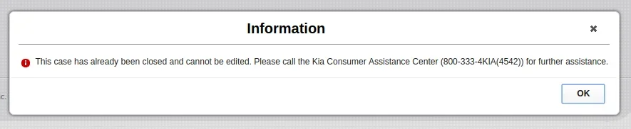

I just went to the Kia website to update my case with the pictures in my previous post, and was met with this.
WTF Kia? Why are you doing your best to get me to hate you?
EDIT: I immediately called their Stinger customer line back, not the one in the screenshot. Spoke to a Michael this time, he seemed more pleasant to speak with. I guess they read the note I left in the case, that I had taken it to a dealership at the beginning of the year and didn't receive help (or knowledge of the customer line or creating a case), as evidence that the case was closed so they closed it. Pretty flimsy excuse, but he apologized and reopened it for me, then took the information for which dealer I was bringing it to this time.
