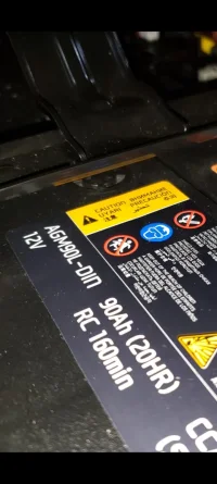

I’m not quite sure whether the current battery is an AGM..is there a way to tell other than if it says AGM on it?
I have just noticed that the new battery that I have just reserved at the store appears to be a non AGM battery, but when I put my registration number in, this is the one it recommended.

So is mine (2018) - Canada 3.3 turbo AWDYep, gonna get the new one installed tomorrow. Mine definitely doesn’t have AGM written on it, so I guess it’s a ‘standard’ version’.

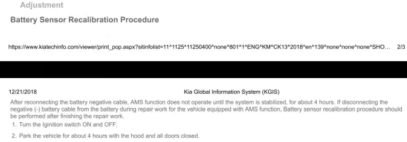

The procedure to reset AMS is to just shut the car off for 4 hours? Is something missing here? I plan to use my XTool to go and reset AMS, or what XTool calls "BMS" after replacement, but was curious about this procedure you posted anyways due to its suspicious simplicity.The owners manual says to charge it by removing the battery. The only reason(s) is an ABUNDANCE of safety/liability

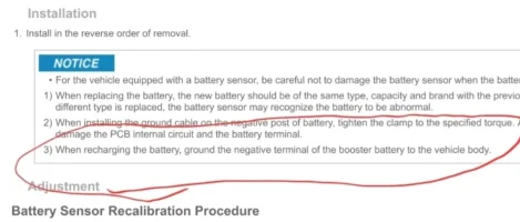

The service manual says to charge it in the car (the Kia service manual), this assumes some basic knowledge so you don't blow yourself up or cause a fire.

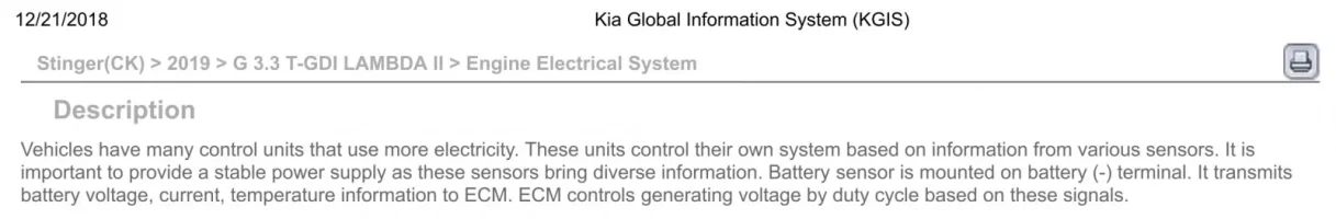

If you were curious about how to calibrate the battery sensor, it is just about the easiest procedure of all procedures. (The acronym "AMS" is Alternator Management System).
The description of the battery sensor - it is basically a current meter that can monitor the current in/out at the battery + temperature and voltage.

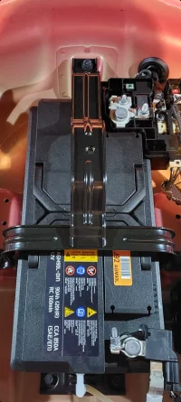

My Stinger GT hasn’t been driven for 2.5 months and it wouldn’t start the other day. I have managed to jump start it, drove it for a couple of hours and then turned the car off. It wouldn’t start again. I have a trickle charger which may help to fix the issue, but I’m not altogether sure how to connect the crocodile clips to the battery, which I’ve found in the boot. Is it just as simple as connecting the red leads to the positive and the black to the negative or do you have to connect the negative to somewhere other than the battery itself? I am trying to avoid buying a new battery.

No need to reset with any "tool" just wait approx. 4 hours with the vehicle off, and doors/hood closed.The procedure to reset AMS is to just shut the car off for 4 hours? Is something missing here? I plan to use my XTool to go and reset AMS, or what XTool calls "BMS" after replacement, but was curious about this procedure you posted anyways due to its suspicious simplicity.![]()
