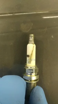

Update. Took the car in and had the 5th cylinder plug replaced (NGK). The bad plug was FUBAR (crack visible at base of electrode). The misfire continued during the test run. Next step was to swap the coil from another car. When the tech went in the new plug was already cracked and shot. Looking more and more like a coil problem.
Here are the plug that came out of Dark_Knight GT vehicle.

Having been a vendor for the Lap3 chip for almost 3 years now we've noticed customers seeking larger gains, selling their Chip when an ECU tune comes out. The Lap3 chip has always been ahead of the game when it comes to tuning/chipping options, well before any reliable ECU tuning has been available. This explains why many customers end up selling their chips and move to a full ECU tune.
One of the #1 selling points for the chip is its "undetectability" to the dealership and is easy to remove. Because of this many customers choose to stay with the chip over an ECU tune which rewrites the code and is much easier to detect
If there is an implication that there is something wrong with the chip or its effect on the engine that's incorrect. Maybe things are different in Korea but any information disclosed openly and transparently here in the web (forums) and no such "offline" meetings take place.
For those using the chip we have confirmed the upgraded plugs for the 3.3TT to be HKS M45iL, this should be the solution for customers using the chip with the 3.3TT.
Price is $180.00 shipped on (6) HKS M45iL plugs, anyone can email us Sales@K8StingerStore.com to place an order
I have been running the Lap3 chip since Saturday on my 2.0. Although I intend on A plug upgrade I haven’t swapped them yet. The increase in power is like night and day. So far I have had no issues and have run the car pretty hard.
Those using the 2.0T need to upgrade to the HKS M45XL
HKS M45XL Spark Plugs
