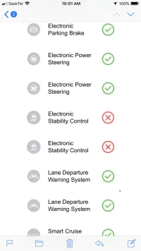

I pulled mine and went for a short drive just before I put it into storage and my monthly UVO report showed an Electronic Stability Control fault. I’m guessing it just detected the fuse is missing as the there are no codes showing in the car on the DIS.

The fault only shows on the detailed monthly report. When I run a status check on UVO I get “all systems normal”.
It’s a GT Limited or the same as the GT2.
Interesting, are you doing this on your computer or phone? Any screen shots you can share?
Here’s a screenshot. I’m not sure why the report duplicates each section but its always done that for me.

Yeah the Canadian one isn't that great either. I'm not overly concerned by what this report says, it's likely the scan that runs didn't detect power from the AWD system so reports a fault and the only place they have to log it on that shitty report is under ESC.
