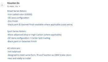

Is there a drilled and slotted option? If these are pretty on par with the Stock OEM rotors, i should probably just save up for the Girodisc.
There is an option to do custom designs and drilled/dimples as well
So typically theres a Street series rotor which is what these are (oem replacements)
then theres the Premium Performance series which is a high carbon rotor (upgrade)
Although the slots may fix the issues of the OEM pads leaving deposits on the rotor
Nice!
Any info on the Premium Performance Series? Again, great work putting this together Nick!
checked out some of there other Performance series. I wonder if they will have the option for Zinc Plating and Gold or Black Zinc options!
When I spoke to them Friday they said the rotors are all made of the same material. The drilled/slotted/dimpled options were what would change.
They said no black/gold as these are already played from the supplier and removing that playing to get a good adhesion for black/gold wasn’t an option.
That Sucks. I would love the Zinc Plating so they would never rust. ehhhh. What material did they say these were all made of? Cast Iron im assuming? Did the say what they were plated with?
You can probably custom order the finish.
edit: nevermind, I guess it's not an option. Oh well.

I contacted Cquence and they set my up with performance "absolute" Dimpled / slottted rotors with a Geomet finish.
