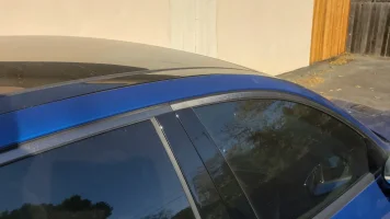

Can you get a photo of your door trim? That is unbelieveable! Hope your rattle is gone though.
Yeah, check it out, one piece is almost bleached white. It's hard to tell because the car is a bit dirty today but the rest have this to a lesser extent as well.
Rattle is still gone, door trim is on order and they're replacing it under warranty so no big deal.
After this I'm getting the exterior detailed, wrapping the roof black and ceramic coating the whole thing, hopefully that puts an end to all the crazy weathering on trim pieces for the foreseeable future...

Thanks for the photo. For some reason, I was picturing interior door trim.
