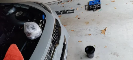

That’s what I did, bought a 2nd set of filters, when the time comes it allows for a quick change over & then time to clean & dry that set ready to go when required.
Speaking of replacing and cleaning. That's what I'm doing currently.
