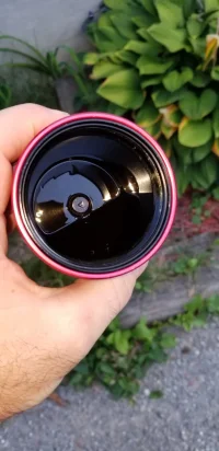

Now my 2019 GT has 31K. Hopefully nothing is mucking up too bad yet. I don’t drive it too hard, only burn non-oxy high-octane and I change synthetic oil every 3500 miles. I read somewhere that helps. :thumbdown:
Never had an issue or been questioned by my dealer about my Catch Can on my Stinger or my Optima that I had. For me it's doing it's job. At 31k, you probably have a good bit of coating on the valves already. My can collects about a teaspoon or two every couple months.
