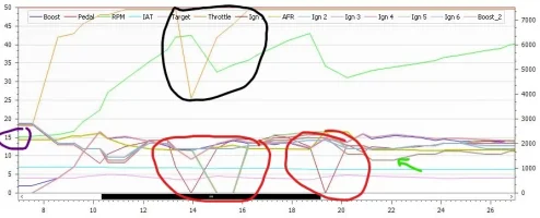

So I had questions about the log I shared on the 1/4 mile thread. I'm not attacking anyone. I am just curious. Seems like everytime someone has a question it gets turned into a shitshow argument....
Red - Why the heck aren't all of my cylinders acting the same? Timing is dropping out completely on different cylinders at different times?
Green - Wtf is this guy doing.
Black - That is a ridiculously long throttle cut and really deep right? What is causing this. I know on the faster JB4 logs, this doesn't cut as deep as it does on mine. This seems like it certainly is wrecking my 0-60 because when this happens, you can clearly tell in my log my speed stops increasing. Also, is this shift long as hell or is it just me?
Purple - Isn't launch control 2500? Why am I chillin at 1500 to start?

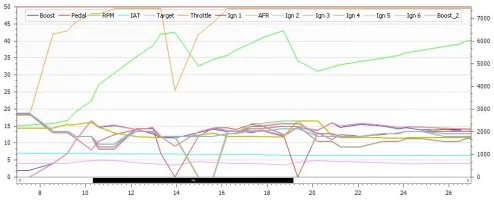

I zoomed in to your run to see what is going on at the launch which is why the X axis is stretched out.
Red - They are. The sampling rate of cyl1 via OBDII and cyl2-6 via a special ECU RAM read are at different refresh rates.
Green - RPM? Looks normal. Zoomed in you can see some of the sample points. With 5 samples in one second you'll see the transitions between the points.
Black - There is no black line here? Throttle looks more or less as it should. You dropped around 2psi at the 1-2 gear shift. Worth fixing but not unexpected given the exhaust mods, map, and intake temperature. Quick fix: Higher JB4 map or IAT wire to get factory target up during cold weather and lower JB4 targets.
Purple - Not sure what you're referring too. Green, engine speed, is sitting at 2200rpm on the launch.
Sigh. I circled with colors the noted areas and then linked the pre circled log... so that post probably makes no sense. In the gym but when I get home I’ll include the correct image.I zoomed in to your run to see what is going on at the launch which is why the X axis is stretched out.
All that timing pull in the middle of fist gear is impacting 60 foot time - correct?
Ok, i see that now. The timing is dropping as the throttle opens and he doesn't get 99 throttle until 22 MPH and that's is 10 degree starting point at WOT.No ~10 degrees @ ~4000rpm @ 15psi is normal timing mapping.
Sorry about linking the wrong thing. Thanks for addressing it anyways. Here is the right one.
Also, I do see I'm at 2200+. So that part I just read wrong.
