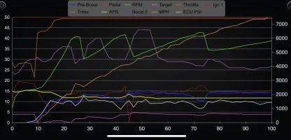

I think the new logging really shows the benefits of adding on WMI beyond just the performance numbers.
Hmmmmm, that looks like a certain special car. That’s an awesome log, I can’t wait to see the numbers.

E6B8AB7E-CFEA-4633-B2B0-E16AB72AE619.webp 5CBC4500-2DE3-40EF-96D2-04ED4C1C90E6.webp Just posted a log on N54 from yesterday’s run. Pulled more boost eliminating wheel spin. Car was stout.
No that's a different car, you're thinking of this one lol. It's decent but not being tuned on a dynojet so numbers are not really internet relevant yet. It's going to need more boost for sure.
IAT wires needed? Looks like the car is definitely limiting it to ~20, so WGC?
For hybrid turbo tuning it's still early days. But to really get the most out of them either JB4 EWG control or a back end flash map was always going to be required.
