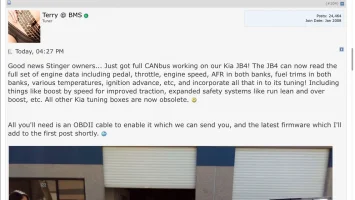

    405F6958-9D6F-44ED-A99D-DE7867A2FA13.png Just in guys! Post from Terry at Burger. JB4 now has Canbus support.

    @Hung tran and I should have the OBDII adaptor soon. Will be nice to have full functionality of the JB4 unit with the BT connect.
