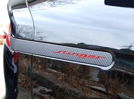

Body Color Painted Side Reflectors
not sides , sort of corners :lipsaresealed::lipsaresealed::lipsaresealed::lipsaresealed::p:laugh::laugh::laugh:
This might help folks make up their minds.
This is the most extreme angle I could get from the side of the car where the reflectors surrounding the tails were still visible.
I was standing about 4 feet away and directly in front of the rear door. I wonder if that will satisfy any rules/laws regarding "side visibility"?
Also, the lights are on in this pic. No light is showing through the paint, for those that asked that question.

You'll notice new cars have tail lights which curve around the side of the car partially. Ours do not, which I assume is why they added the strip, as they must've wanted the specific rear tail light design. E.g. look at new BMWs.
I thought many years ago, US mandated tail lights on the side?
I think they wanted to get creative with the side reflector. This was a design element they kept from the Stinger concept from several years ago. I can't think of any other car with a taillight/reflector assembly like ours, it's nice to have at least a few unique exterior design elements in an era where virtually all cars look very similar to other cars.

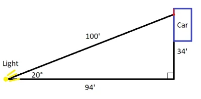

Ah! Lots of boring reading later, I found the section that mentioned the requirements for the reflector. Looks like it's not a size requirement, but a luminescence requirement. That's a lot harder to test. Lol.
Basically: Shine a light on it from 100 ft away, if it shines back with a luminescence of X (From what I can tell, it's like .1% of incident luminescence), then it passes. The tests are performed at a max of 20°, so if you -really- want to be safe, test the reflection at 100 ft 20° to the front of the car. IE:
If you really want to get technical from that point, there are reflective luminescence requirements listed in the tech docs sheet: Reflex Reflectors—SAE J594f
Though I think you could settle for "Easily Visible". I'm pretty sure that completely blocking out the reflector makes it fail the 20° to the front test, but punching out a small segment would be fine, albeit funny looking.
Long story short: If you block em out, you're probably technically violating safety standards. Cross your fingers and hope nobody calls you out on it if you get in an accident, or you could have an expensive problem... Thought I think the one with the 'Stinger' script cut into it would be fine.

Assuming these would be under or around $20 for the pair id take them in CS as soon as you had them ready lol. Would love it if you can get a cut out of STINGER though the middle like these
Or, paint the car red and let them blend in.
You have any ideas what the price point will be Sal?
They're going to be $90 or $100 per set. I'll sell the initial batch for $75.00 per set. They're small enough that they can sit on my shelf for eternity if everyone feels they're too expensive. If it turns out they go quickly as people don't feel like having it done themselves, I'll buy in higher quantities and get the price down further...
That's a great price. A lot lower than I paid for sure.
