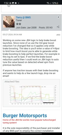

Are you actually seeing boost when doing the launch control? My car holds higher rpm when doing the launch with the BMS TCU but the boost is still 0 on both the JB4 and the meth boost gauge.
I think it just ramps up the boost during launch. See the log from Terry. I don't think it builds boost. Maybe if 3rd gear redux is set to 0 it may.
I tried today with 3rd gear redux @ 5 and it was decent. Will be better with stickys or lower tire psi but I'm rwd.
