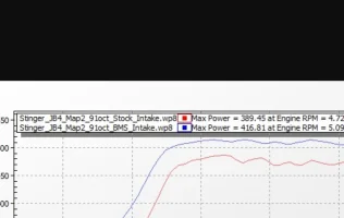

I’ve been looking into the bms intakes and while looking over the dyno graphs of the stock car vs the shop car with the intake. On map 5 the stock car made almost 395 and the shop car with intake made 441whp is this correct?
FYI all the intakes make similar HP perhaps with the exception of JT and SSR probably make the most power....No way an intake is giving you 46 WHP LOL....Any intake you buy will net you similar horse power gains.....

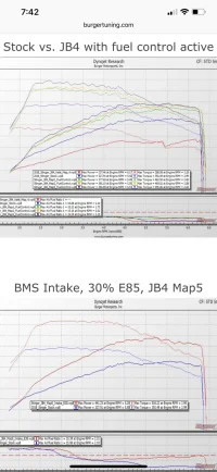

B46794B8-7F4E-4CCF-803A-B87C603E6630.webp Yeah that’s the vs on map 2. This pic shows map 5 on stock car and on shop car with intake.
Edit terry said the difference in power could be down to different gas as well as different firmwares on the jb4.
