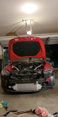

Snapchat-778863618.webp Update: 2nd attempt at install was a success. Taped up the tow hook mount to avoid scratching the intercooler. Had to use some "persuasion" with a hammer a bit on the intercooler bracket on the passenger side but it worked. Definitely jam packed in there... but in there.
