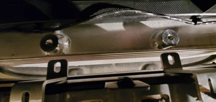

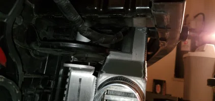

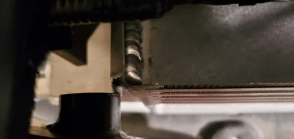

Got mine on Wednesday and tried to install today. I must have gotten a bad one because there were crazy fitment issues. Passenger side was hitting the tow hook mount, the Z brackets were about 2 inches off from lining up. In the pic you can see the passenger side needs to come forward so the grommet will fit into the intercooler top bracket, but it's hitting the tow hook mount, so can't move forward...

Did you put it in backwards lol? I had to knock the passenger side bracket out about 1/8" but other than that it fit perfect.

Lol I thought that... but no. There's only one way to really mount it or the brackets would be really off

@Terry@BMS Any ideas or suggestions?
Loosen the mounts and make sure u slide it all the way to the drivers side
