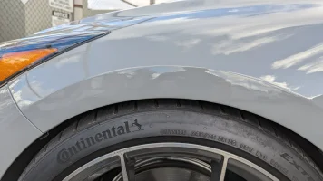

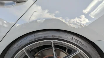

Not sure why you're maxed out on lowering we have the same spring rate, been driving in the rain so the car is dirty, 26" even all around from ground to top of fender gap, but you can see I could easily lower past drivabilityPXL_20240406_002736840.jpgPXL_20240406_002628727.MP.jpgPXL_20240406_002621341.MP.jpg
Did you measure the front spring's free length before installing? If not, quite often it is silkscreened right on the coil. Like here, 160-08 means 160mm free length and 8kg/mm.
I didn't. And not sure what they are from bc.

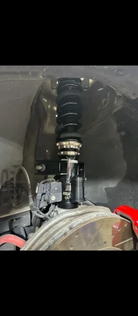

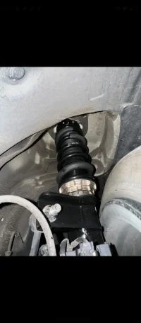

This is about all I currently have as far as installed pics.

Those look like at least 8" long springs. BC Racing only shows BR series for the Kia Stinger on their website, which according to the pic posted is 160mm (6.3"), which is the same length as Riaction's. The only difference is BC uses 62mm ID springs, while most coilover brands, including Riaction, use 65mm.
If that is the case, then I have no doubt they can drop the car as low as shown on k8stingerstore's webpage. Not that I think it's a good thing to go that low, but that's a personal preference.
Did you buy directly from BC? Yours look a lot like what K8stingerstore shows on their webpage, with the same long springs. I suppose it's possible BC could've built a batch of them according to that vendor's specs.
Well, you can solve the puzzle by removing one front wheel and measure the spring length. Add 5-10mm to account for the preload (if your guy did it correctly), and that will be your front spring's free length. Or, read the specs printed on the coil.
You can always get replacement springs that are shorter, either from BC or elsewhere. Any 62mm metric coilover springs would fit. I would recommend Swift, but it's up to you.
