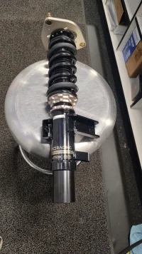

Well, these are going on tomorrow. Can't wait to see how the car handles after. Anyone recently had experience with them?IMG_20240404_104021890_HDR.webp
Please, do a review on them.
I've been stalking these for awhile!! I really want to get your thoughts on them after you're install. :thumbup:
Dropping the car off this afternoon with a buddy here in Indy. Should be about to pick up tomorrow afternoon. I ordered them about a month ago and they finally came in this morning. I really hope they are worth it.
Those look pretty sweet.
Did you get the default spring rates? or custom?
I went with default springs for now. The Swift ones were available but too many people I talked to said the Swift springs aren't the way to go if you are daily driving the car and I am. Also, I believe the Swift springs would only be put on the fronts and no rears if you do them.

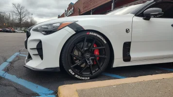

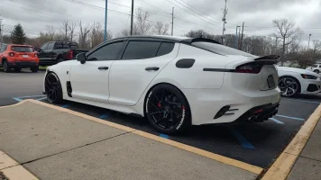

Post some pics. And what is the driving impression?

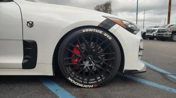

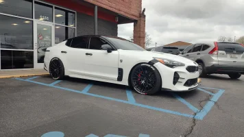

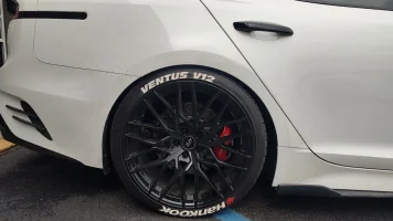

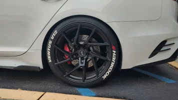

IMG_20240405_095709207_HDR.webpIMG_20240405_095703258_HDR.webpIMG_20240405_095655193_HDR.webpIMG_20240405_095643807_HDR.webpIMG_20240405_095636721_HDR.webpIMG_20240405_095629626_HDR.webp
I think it sits great. How is driving with them?
Did you measure the front spring's free length before installing? If not, quite often it is silkscreened right on the coil. Like here, 160-08 means 160mm free length and 8kg/mm.
Only had a little drive time last and on the way to work this morning. Not bad set at the mid point as far as the adjusters. Hopefully i can get out this weekend and get a better feel for what they are.
I started in the middle on the adjuster and just went up two clicks yep just drive and get the fell wait a week or so for the alignment.
I'm set at 0 camber front and 1 1/6 rear, after a year of hard driving my front tires look great even wear, rears do show some on the inside but I'm running 285/30/20 on that 10.5 rim so the camber let me tuck them with no rubbing
Yeah, I'll wait on the alignment. It really does sit about identical to what it was like on just springs. Never had a rear rub issue. Same tire you're on.
