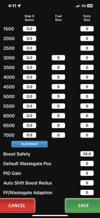

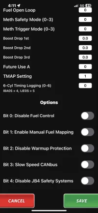

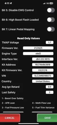

we have a new problem. feels like the car goes into limp mode when in map 4 and 5 (more common in 5 but happens in 4) - it doesn't happen in 3. I don't think its limp mode though. I'm not overboosting, I've checked logs.
First I thought it was because my octane wasn't high enough, So I added some extra E. then it kept doing it, so I thought I added too much and put fuel bias up to 119, albeit it may have felt a little smoother, it kept doing it. no idea what's going on, as map 3 works perfectly fine as every other map does.
in some cases it completely removes boost until I stop and start the car again, other times I switch to a lower map and the boost is all there.
upon checking logs, it shows the gear switches and the pedal goes to zero - but my foot doesn't come off the pedal. even though it says zero, my foot is still most definitely on the pedal in that moment. its like the ecu is saying 'no more' but nothing appears to be wrong? i only got one map of it and its short but it shows everything important i'd think.
