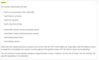

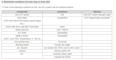

These are the conditions, for those curious

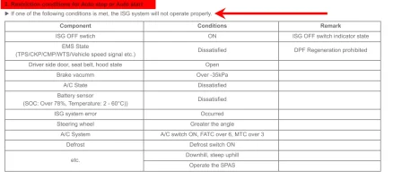

There must be dozens of threads about ISG (Idle Stop and Go) and the weird things it does. There are simply so many inputs to the ISG (Idle Stop and Go) system and so many combinations of different conditions that must be met for the ISG (Idle Stop and Go) to show an 'OFF' amber light, a green / amber / none, icon in the HUD, a green / amber / none, icon in the LCD panel, a green / amber / none, icon in the tach. {I've never seen the ISG (Idle Stop and Go) icon appear in the speedometer, but I won't be at all surprised if some day one does.} When all its conditions are met, it works great and may save a little gas. When the conditions aren't met, it quits stopping the engine. Kia dealers have enough trouble trying to change the oil. Deciding whether or not the ISG (Idle Stop and Go) is working properly is so far above their pay grade, it is pointless to harass them about it.
Please just accept it as one of the charming eccentricities of the car, and enjoy what a great vehicle it is.

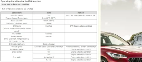

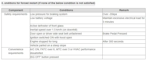

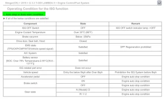

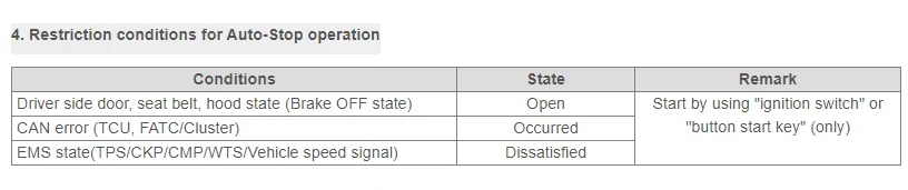

The car can't always auto shut off due to demands on the system, such as the air conditioner running, or the engine hasn't warmed up enough on a cold day. One thing I have noticed is that when I'm stopped at a particularly long light, the car restarts before I go, so it seems like there might be a timer on how long it stays shut off, or possibly the system suddenly demanded power again for something.
Post #21
There is a max time of 300 seconds!
And many other conditions...

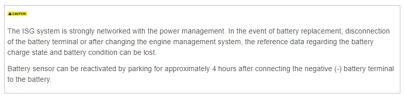

Each time the car is started the Idle Stop & Go Resets, meaning it will in the "ON" mode
I ordered one of those memory modules from Shark Racing. When it arrives and I get it installed, I will post back on how well it works.
