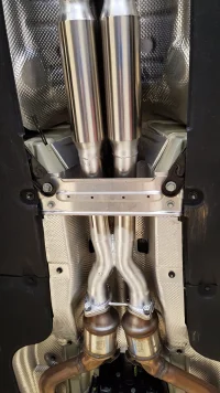

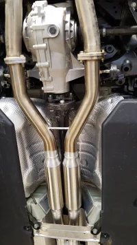

Its different for me, since I have ultimate performance downpipe/midpipe with high flow cat and ark exhaust, drone can get pretty loud around 1500rpm-2000rpm. Dynamat,closed cellfoam, and mass loaded vinyl has helped, but im still getting some resonance within the cabin. Need to figure out where its coming from and apply more I guess.
Good luck with that, i couldn't tolerate it.
My local exhaust specialist moved the mid pipe to the front somewhat and added 2 extra resonators to a fabricated pipe. He also decreased the flow a little. All in all it worked.20190122_142041.webp 20190122_142750.webp 20190122_142750.webp
