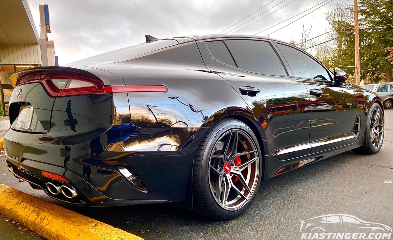

FWIW, I'm running INOVIT Vector 19x8.5, 19x9.5 with Conti DWS06 in 245/35 and 285/30. So slightly different wheel widths. IIRC my offsets are 30 and 40. They fit, front slightly inboard, rear flush. And snug.

Thanks. So 19x8.5 ET30 and 19x9.5 ET40? Do you think ET35 would fit in the rear? I think that's 5mm further towards the outside of the car? Lowered or not?

35 rear would be a slight poke, I think. Mine's lowered, Eibach. With 35 it seems to me it'd be *very* close on the wheel arch...but then it is just a 5mm difference. Less than a quarter inch. Might be okay?

So after all that what I received was 19x9.5 40 offset for the rears instead of the 45 spec'd, but I figured we'd just see how it went. Good news! Poke vs. no poke is a preference thing...for me it's not something I want on mine. So I was pleased to see what I'd call fluuussshhh on the rear, slightly tucked front. I can live without the 5mm.
Final specs:
Inovit Vector in silver (they also have black) from Fitment Industries, all TPMS and lugs, etc, in the package.
19x8.5 35ET with Conti DWS06 245/35/19 front
19x9.5 40ET "" " " 285/30/19 rear
View attachment 35171 View attachment 35172 View attachment 35173 View attachment 35170
