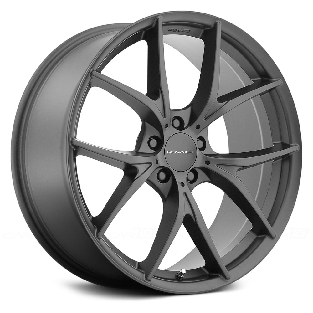

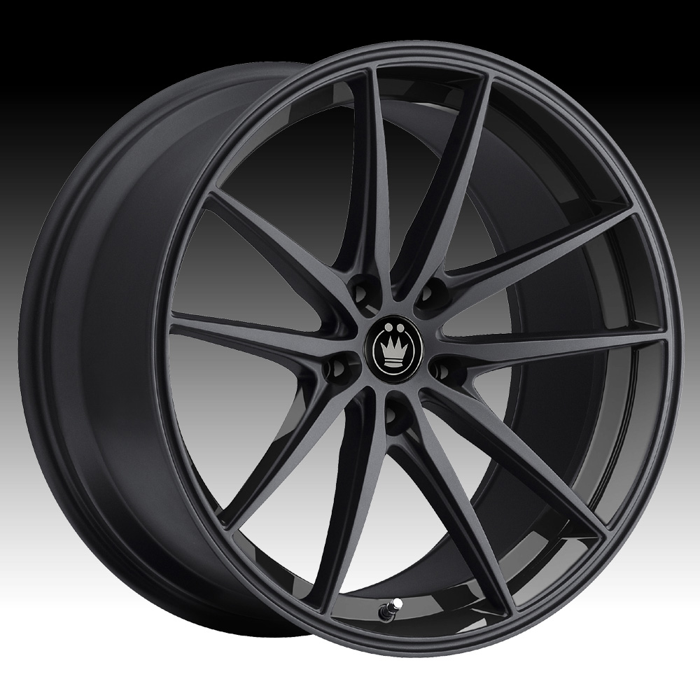

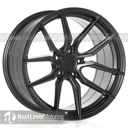

My backup plans are below but again, can't find any concrete info that they will fit (but some fitment guides indicating they won't). Obviously any problems with fitment will be related to caliper clearance to spokes or valve but that seems to be impossible to figure out without test fitting (and I'm not wasting a bunch of money sending wheels back and forth that don't fit).
KMC KM694 Wishbone 18x8 +35mm.

18x8 Black Konig Oversteer Wheel +35
XXR 559 18×8.5 +35mm

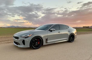

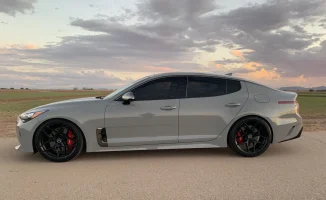

Brixton RF7 20x9 35mm & 20x10.5 40mm. Nitto NT 555 G2 245/20/35 & 285/20/30. H&R rwd springs.
