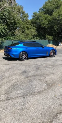

ARK 270s 19x9.5 +25 with 255/35 all around in Hyper Silver.

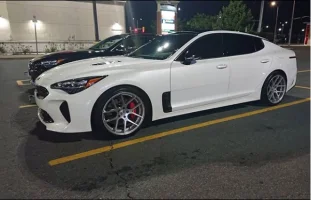

Got these vossen rims w the Tokyo tires I think it looks pretty good
Vossen 20” look fire

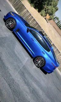

Wheels: Koya Semi Forged SF04
Finish: Kingsport Grey Gloss
Front: 19” x 8.5 & offset: 32mm
Rear: 19” x 9.5 & offset: 38mm

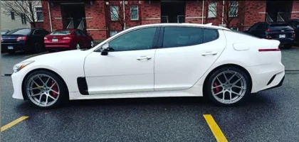

Just got my new rims and tyres today, Koya SF10 20inch rims in Satin Black. With Pirelli Dragon Sport Tyres.
20*8.5 with 245/35/20 on Front
20*10 with 275/30/20 on Rear.
No scuffing or rubbing and the offset is perfect as they do a custom fit. I think I might look at a 285 for the rear on the next set of tyres as they look a bit stretched on the 10 inch rear.
