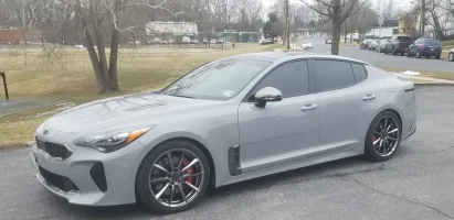

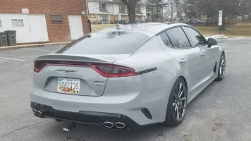

Sorry. :P Watkins Alloy Wheels by TSW
1985WAT405114B76L 19x8.5 5x114.30 40 6.300 DOUBLE BLACK - MATTE BLACK W/GLOSS BLACK FACE 76.1 1725 22 440.00 CCPCG18-T
1985WAT405114B76R 19x8.5 5x114.30 40 6.300 DOUBLE BLACK - MATTE BLACK W/GLOSS BLACK FACE 76.1 1725 22 440.00 CCPCG18-T
1995WAT395114B76L 19x9.5 5x114.30 39 6.800 DOUBLE BLACK - MATTE BLACK W/GLOSS BLACK FACE 76.1 1725 22 440.00 CCPCG18-T
1995WAT395114B76R 19x9.5 5x114.30 39 6.800 DOUBLE BLACK - MATTE BLACK W/GLOSS BLACK FACE 76.1 1725 22 440.00 CCPCG18-T
I just noticed that my rears are 9.5, not 9 (looked at the invoice more closely; and I should never go just off memory of what I was told, heh!:rolleyes:)
do you think 9" would fit in the front? because I love the concave look on the rear
Can't help. There's no way I understand offsets. I just do as I'm told. :P (Btw, that rear concavity on mine is 9.5, not 9; I was mistaken and have edited my post above.)

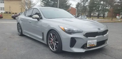

That looks really nice!!!! This is the same set-up I plan on getting in the spring. Thanks for sharing!!!
It looks like you still have the black shipping tape over the black chrome trim. Or am I seeing a reflection?
I think Rylark is referring to the brushed chrome trim that runs along the top of the door/window frame. You'll notice the brushed chrome trim along the sides of your rear hatch window? That brushed chrome trim keeps going along the top of the door/window frames all the way down alongside the A-pillars. The brown/black plastic is just a magnetic tape-like protection for the real brushed chrome trim--it will peel right off. The guys who detailed my car and applied the PPF told me about it. I just left the tape on there at least until the end of winter.
Gents, great call. There was a protective film on that trim, I have no idea how I never noticed it. The dealer totally screwed up my PDI, I was finding plastic on the car for weeks. Just add that to the list. Thanks!
