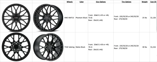

I am finally (after nearly 60 days) looking to add wheels to my 2019 GT2 AWD - Ceramic Grey (on Eibach springs). I have narrowed it down to two options but wanted a second opinion on the variations. Specifically in: tire size and offset (closest to flush). Also does the center-bore make a difference?

Thanks in Advance!
Thanks in Advance!
Go for the lighter wheel

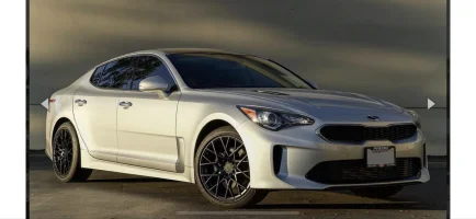

Thanks in Advance!
I really appreciate the opinions and recommendations. And that pic helps me get an idea too. Thanks all!
With the offsets and widths your looking at, it will look sexier than that photo for sure too, that care looks the have 8” or 8.5” front and rear. Your fronts would look like that and your rear more concave.

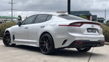

I recently got some 20"s with 245/30r20 on the front and 275/30r20 on the rear(pictured). I've booked it into get Eibach PRO's fitted next week but I still think the fronts are a little too thin.
Is anyone running a 1" lower with 245/35r20 on the front and 275/35r20 on the rear? So 35's all round? Or 35 front, 30 rear maybe?
Cheers,
@basysmith I would go 35 all around, 30 is way too thin IMO. 35 is still rather thin for me but going to 40 might throw it off way too much from the stock size. I am debating on 20's also, and planned on going 35 all the way around.
