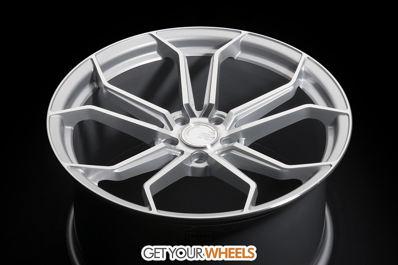

These come standard in Silver Machined but they can be coated to any finish.

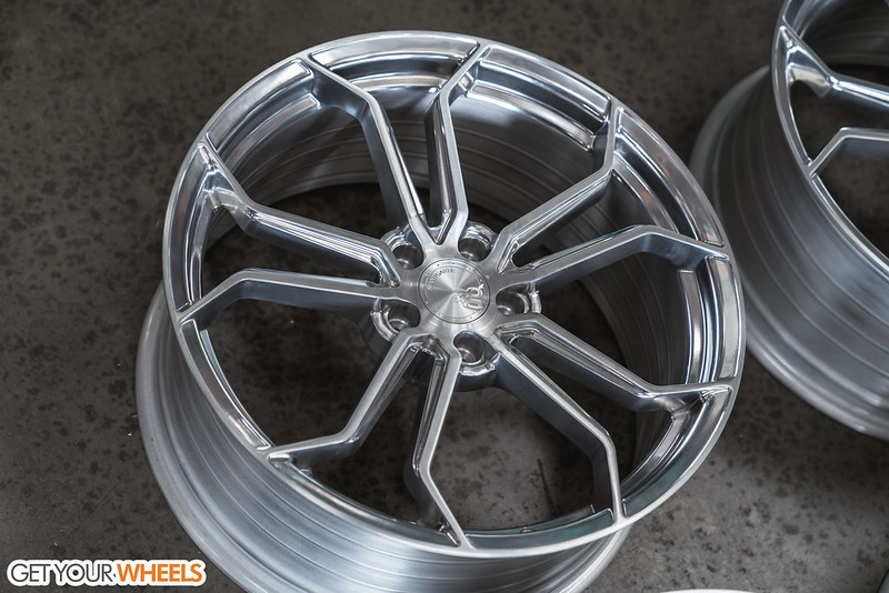

Coated to Matte Textured Gunmetal
This one we did in a Gloss Brushed Polished finish.

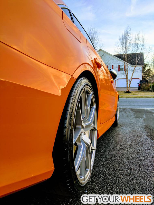

So ... question, would 8.5 19' wheels be conclave? And what size tires and offset would you recommend for an 8.5 19' square setup. Want the tires to be flush with the top of the wheel wells, NO STRETCH, and same circumference as stock 19' wheels and tires. I'm also lowered on Eibach Pro springs. Thanks.
19X8.5 is a standard face so it'll be more like this below but that is whats needed to clear the front brake caliper.
If you want ZERO stretch and EXACT same OD as the stock 19" wheel, then you'll have to run the 255/35/19 on the 19X8.5.

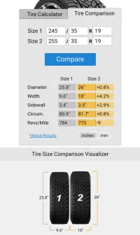

We can't get concave wheels on the front of this car because of the big brake we have, the back no issues. But would be nice if all four wheels are concave! Anyways what is the difference between 245/35/19 to 255/35/19 tires?
245/35/19 is 1% smaller than the stock OD.
