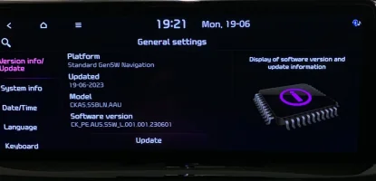

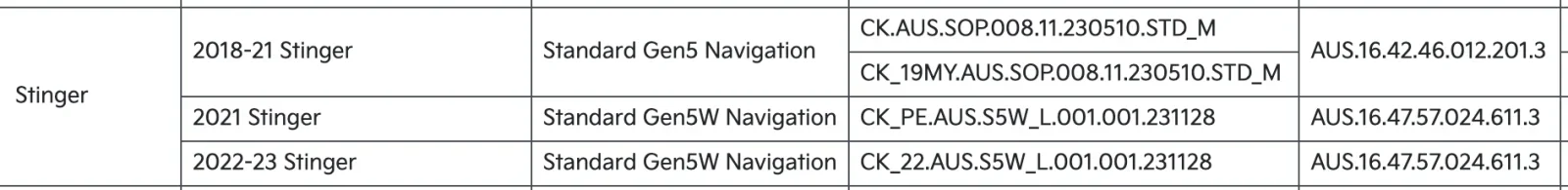

My mega beast is a MY20 with "Standard-class Gen 5 Navigation ( 7 & 8 in. Touchscreen)".
I downloaded the update and transferred to the SD card OK, but my vehicle didn't offer to apply the update automatically - so I did it manually though the setup menu, and it said that the software version hadn't changed but it would happily reinstall if I really wanted it to, which I made it do.
The software version hasn't changed since May 2023, and I am not sure either about a Map update - and can see from the software list that our vehicle map version is now out of step with the newer models.
In my mind, if you updated in May 2023, then the December update is most likely to be no different to that.
