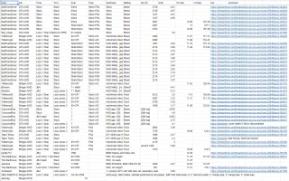

If you get really bored/can't sleep again here's the list of top 20 1/4 mile runs posted on the forum, with their supporting mods.

Updated
I'd prefer to get more data on JB4 without mods or only intakes. That's the real gap in data and I think FBO isn't as popular overall. Lots of lurkers in here just trying to decide how to OEM+ their cars. Difference between them and I is maybe I'm more outspoken, or just willing to accumulate data :coffee:
I updated the spreadsheet above with sorting by car setup. Still not sorting by car, tire or track/street, as those who go all out on setup tend to be on the track. Chart below, separating into groups by mod (hardware setup, ECU and TCU tune) (also in the link)
I wish I still had JMP on my work PC or I'd be able to do much better statistical analysis, R^2, std deviation, etc. As-is, I think the takeaway is still that the ECU tune alone is as fast as FBO JB4 on pump gas.

Updated
