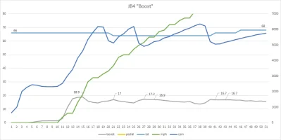

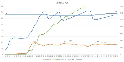

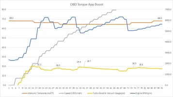

I finally got around to comparing JB4 boost to Torque OBD app boost. Did 2 back to back runs from the same location, same starting IAT, 0-100. JB4 "ECU boost" shows 1 to 1.5 lower than Torque ECU boost and JB4 "Boost" shows 1.5 - 2 lower than Torque ECU boost. (using Map 0) Can't guarantee the Torque app is correct since I don't have a gauge but weird they both read ECU boost so differently.
So 3rd gear Torque app show 19 PSI and 3rd Gear Jb4 Boost is 17 PSI. Also on latest firmware with the higher boost readings. (last 2 graphs are the same run just showing each JB4 boost separately)
I wonder why the values are different.
Is the data source different in the two systems?
My first thought aswell, maybe taking the boost pressure from different sources/places in the tract or running the same data through different algorithms to come up with the results?
Biggest variable is probably going to be the zero point (e.g. ambient pressure), whether it's being computed dynamically like the JB4 or a pressure gauge would work or static like many logging apps use.
