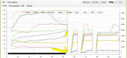

I got one big overboost logged. File is attached.
Just doing a mild acceleration on the highway and boost went up to 26psi. Then almost no boost until I restarted the engine. No error code at all.

Do you have iat spoof turned on? That makes it easier overboost.
6th gear 3K rpm is a tough pull. Lots of time to build boost.
When ECU PSI gets over 16 timing is dropping to deal with it but boost still climbing.
JB sees the overboost and drops the target from 6.8 to 0 which causes immediate ecu over boost and limp boost mode.
Why the boost kept climbing, not sure.
Looked like a pretty cold day given the IAT.
Timing is mapped on boost so that checks out. :)
ECU PSI converged on actual boost as JB4 disabled itself due to the over boost. But generally speaking this is a classic sign of too much WGDC. When more EWG connectors show up we'll get a harness out for you to test. Until then I suggested testing the options.7 on to try to reduce boost requested at 70% throttle input.

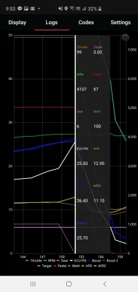

I am looking more at the logs. Is it normal that bank1 and bank2 AFRs differ at peak boost? (12.9 vs 11.1) It seems that bank2 is pouring much more fuel. Or does it happens for a too short amount of time to be relevant?
