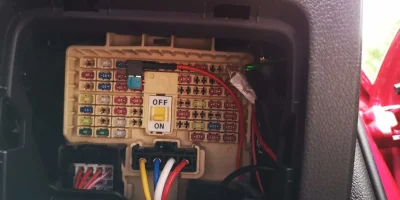

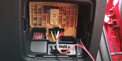

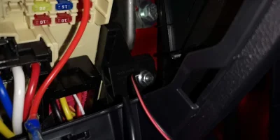

4) Choose the fuse you're tapping in to. I've chosen the one which controls the interior lighting so my dashcam comes on when the dome lights come on, and goes off when the car is locked and the dome lights go off.IMG_20180613_191322.webp
5) Take this fuse out, place it in your add-a-circuit then put the add-a-circuit in it's placeIMG_20180613_191234.webp

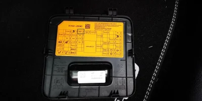

6) Now we need to earth/ground it to the car's body with the black wire from the 12v adaptor. Luckily to the right of the fusebox there's 2 nuts, the bottom of which is just accessible with a small spanner. This is the most difficult bit but with some patience you can loosen it just enough to slip the bare end of the black wire behind, then tighten it up again. Took about 15 minutes.IMG_20180613_191219.webp
7) We've now wired in a 12v charger to the fuse box! Go ahead and test it.

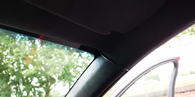

8) Now install the dashcam on the windscreen. I have mine just to the left of the rear-view mirror. It's not a perfect location due to the cameras and sensors but it's the best discreet location I could find. Then the cable tucks nicely into the headlining where it meets the windscreen. Route it towards the drivers side.
9) Now it goes around the A pillar and tucks into the door seal rubber. When you're done this is the only bit if cable you'll see, apart from where it enters your dashcam.

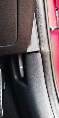

10) Now just run it down the door seal. Gets a bit tight near dashboard so I had to use a trim remover tool to poke it into place. Kia have used very heavy duty seals.

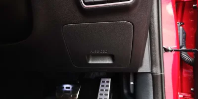

11) Just below the dashboard there's a handy gap where the next piece of trim slots into place. This is perfect to run the cable around, then up into the fuse box and out the front.

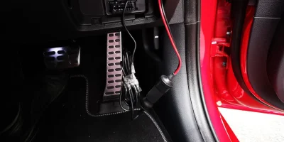

12) Connect the power cable into the cigarette lighter, bundle all the spare cable up and get it all nice and compact. (I'm going to go back and tidy mine up now it works).IMG_20180613_191130.webp
13) Push it all into the gap to the right of the fuse box, where the nut was we used to earth it. It's a large space and it all tucks up there nice and neat (unlike mine!).IMG_20180613_191102.webp

On Step 9 if you take that trim removal tool you can shove the wire between the A pillar and headliner.
Nice write up.
Good point! Thanks

Hey, nope I don't but that fuse always has power from the moment you unlock the car to when you lock it again and walk off. I think it controls more than just the dome lights, it does the footwell lights and all sorts. I was going to use the fuse marked "power outlet" but they don't come on until the ignition is on, and I like the camera booting up a bit before then. That was my plan b though.
