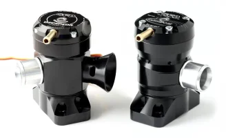

Kit 1 - (2 Mach2 Recirc valves )
This kit is designed as an OEM Replacement
No more sound over stock
Direct recirc back into intake just as the OEM Valves would
Kia Stinger GFB TMS Mach2 Recirc Blow Off Valve BOV
Kit 2 - (2 TMS Hybrid valves)
These are dual port blow off valves
They can be adjusted for 3 settings
Full Recirc, Full Atmosphere, and 50/50 split recirc/atmos
Adjustment requires disassembling the blow off valve
Kia Stinger GFB Hybrid Blow Off Valve BOV

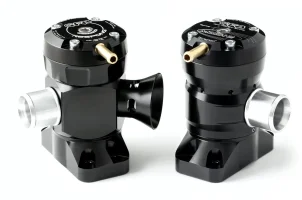

Kit 3 - (1 "Respons BOV & 1 Mach2 Recirc")
The Respons blow off valve, unlike the hybrid is not limited to 3 setting
The Respons can be adjust as much to atmosphere or as much to recirc as you wish. So you can fully adjust the sound to youre liking
The Respons can also be fitted with GFB signature trumpets to dramatically change the sound
Adjustments for sound are done with dial versus disassembling the valve
Kia Stinger GFB Respons Blow Off Valve BOV

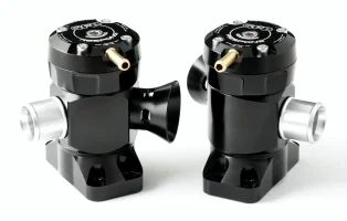

Kit 4 - 2 ("Respons Valves")
Same as the KIT3 but dual Respons valves versus 1 Respons 1 TMS Recirc
Kia Stinger GFB Response Bolt On Blow Off Valve BOV
Kit 5 - ("1 Deceptor Valve & 1 Mach2 Recirc")
The Deceptor valve has the same adjustabily as the Respons but instead of having to get out of your car and adjust the dial on the bov, the Deceptor is adjusted with module that can be placed within the car, allowing you to adjust the noise at the press of a button
Kia Stinger GFB Deceptor Pro Blow Off Valve BOV
